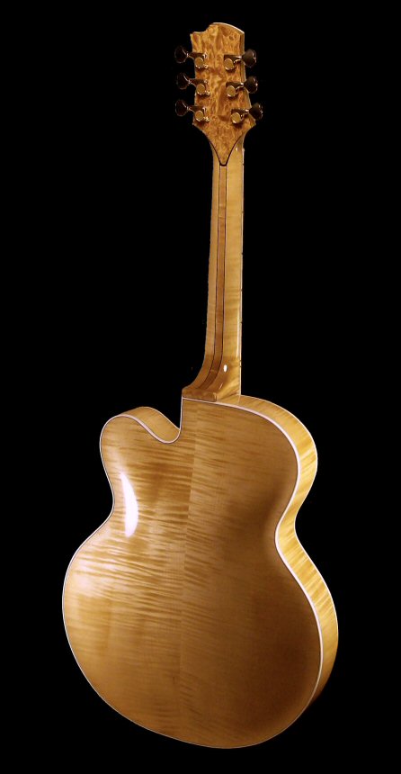

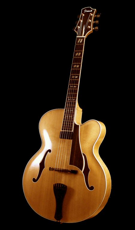

I'm glad to finally be able to post a few shots of my 2nd and 3rd, built side by side & just recently completed.
The "blonde"
  • Euro maple B & S, sitka top, mac. ebony fingerboard & fittings, fully bound
  • Kent Armstrong handmade 12-pole PAF with thumbwheel volume

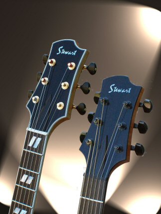

  • Gotoh 510 21:1 tuners
  • 17" lower bout, 2 13/16" depth, 25"scale, 1 3/4"nut
  • finish is aniline dye on bare wood (sanded back to white & reapplied), then system III & Target Ultima

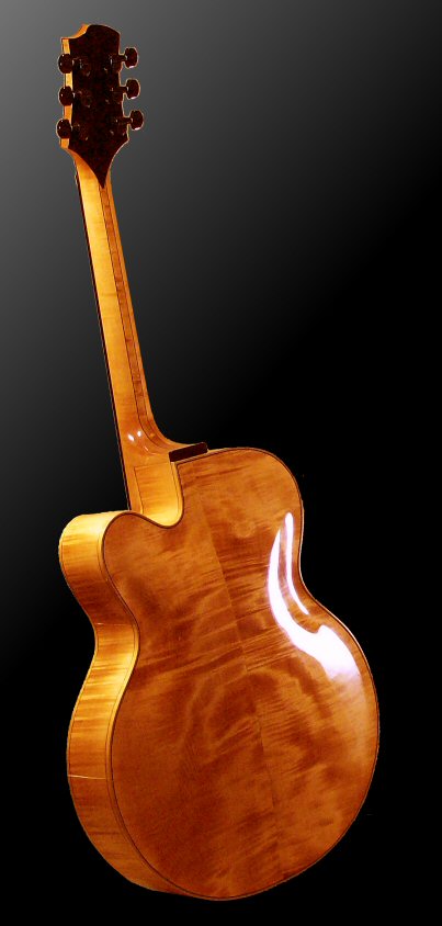

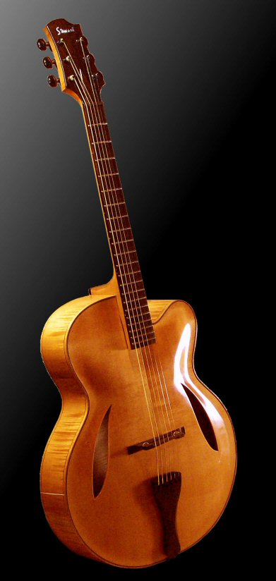

The "redhead" is the same but for Englemann top, 3 1/4" depth, 1 11/16"nut,  Schaller M6 tuners, unbound neck & head.

Now that is two fine looking guitars!
It is amazing how the binding on the headstock adds some "bling" to it.  Good Job!

Wow! Dave, I LOVE the color you have on the second guitar's
soundboard. Both are incredible! And I LOVE the headstock design!

Very nice looking!! I really like the second one!

Awesome finish on that beautiful maple. I am so excited to see people use the tiger maple as I intend to use it on my first build.

Thanks Shane...love the 510's!
I went ahead & got some extra-fine menzerna. I think it really improved the finish (FWIW)

Danny, Paint Shop Pro is a "poor man's" Photoshop. Water dyeing bare wood is problematic - works great for sanding back & "poppingthe grain". Not so great with softwoods, sandthroughs & matching. (Tips welcome)

Mucho kudos Dave! I'm with Billy...I'm really drawn to the "redhead". But redheads are so sexy anyway.
